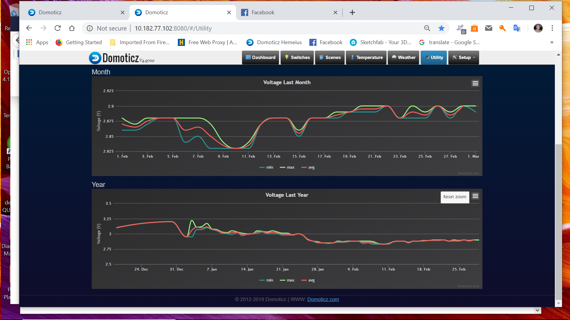

                              @njwyborn No offence intended Nigel but perhaps you might stand back a little from the WDT and solar concerns, and concentrate on the efficiency of the Node.
                              I've just graphed the 2AA alkalines for the US Water Tank Node, as attached :
                              ![alt text](0_1551454531985_cb4d7594-5461-459e-b4d8-9cb1cfaf02df-image.png image url)
                              This Node sleeps between hourly wakeups from the RTC, and aside the initial drain in January prompting me to limit the program sample loops, there has been no dramatic voltage drain, it probably will exceed 4 months. There are no smoothing caps at all in circuit aside what are on the boards, and it has never skipped a beat aside from condensation build up on the sensor (<-5c I noted) causing an abort from sending in a crazy reading or after 10 attempts without success.
                              Presumably you have a need for 10 minute samples, but am completely baffled on running the JSN constantly. It takes <100ms to warm up from the latching relay kicking on with zero consumption, and aside from the drip events has proven reliable...
                              Will change the conduit from gunbarrel to plastic over the summer as I suspect the condensation source is the tube (heatsink to external -5 to -16), but putting off the solar charger notion until I figure out whether it causes more problems than it's worth, and watching your progress accordingly.. ;)

                                • N Nigel31
                                  Hi @zboblamont
                                  No offence taken at all. I chose to keep the sensor powered simply as a debug process, to eliminate "extra" hardware and code, in an effort to see if somehow that was contributing to my woes! I will re-instigate powering the JSN sensor with the mosfet, as clearly there is no indication that powering up the sensor was causing a brownout, and thus lockup. the other battery nodes have run for months with no issues on 2xAA batteries, with much life remaining in the batteries, and no lockups. The 10 min interval is because the same node also reports external temperature, which I use to accelerate or retard the central heating timing, and set point.
                                  Returning the efficiency of the node to the original however won't help me with the locking up issue, for which I don't seem (as yet) to be able to tie down, and given that a reset ALWAYS "fixes" things, this is why I am pursuing a WDT as a "solution"
                                  Given that the only real differences between this problematic (rebuilt with alt hardware) node and others is limited to
                                  1. Powersupply, lipo battery and solar vs 2xAA Alkaline
                                  2. A ultrasonic sensor
                                    I can eliminate (1) by powering the node with 2xAA, and see what the results are, and I can change the sensor type to a Sharp GP2Y0A60SZLF Analog Distance Sensor (which was my original design before deployment), however the sensor output isn't linear, and whilst I came up with a quadratic equation to approximate the distance, it wasn't ideal.
                                  I am intrigued with your comments regarding limiting the number of pings / time limiting the loop. In my sketch I utilise the new ping library with a median request of 10 pings, I am assuming that the library employs timed loops to create a "window" for pings, based on the maximum distance you tell the library you are interested in, and thus (hopefully) it never gets stuck in a loop waiting for a ping which will never come, or it has already missed. Do you use a library, or do you use your own code to generate and measure pings, thus calculate time / distance?
                                  Many thanks
                                  Regards Nigel

                                  • N Online
                                    N Online
                                    Nigel31
                                    @zboblamont . Have modified hardware, re-instated mosfet power of the Ultrasonic sensor AND am currently using 3xAA Alkaline batteries, The UC is now powered again from RAW battery voltage, as seemingly (not definately) stepping up to 5v didn't help much, and added noise (undoubtedly) and power overhead, however small.
                                    It's working at the moment. I know thats several changes in one go, however given the mtbf, I will be at this for many months. If this is no more stable than any other versions, I will re-instate the LIPO battery / Solar charging to the circuit.
                                    I see you are indeed "doing your own" pings as it were, however for the moment I will persist with the newping library, as the last "failure" definitely occurred post "pinging". Also you use sleep's rather than wait's. Ill have to look into this method myself.
                                    I have investigated several single chip WDT's however they all have short reset time requirements (1.2s max, most a few hundred ms) so it looks like I would definitely need to make my own circuit, seems strange, but I can't find anything with a "interval" in the many mins. Unless I sleep in a loop, reset the WDT, sleep again, and count say 1200 loops of 500ms sleep, then continue on with my main loop.
                                    Regards Nigel

                                      @njwyborn As an afterthought, forgot to ask if your mosfets are switching power to the US or Ground ? Reason being I vaguely recall reading these SR04s should be solid earthed and not switched.
                                      I'm happy enough with the current setup and results, and no ill effects from the 5v booster contrary to expectations of noise, though it was parked in the case with the ground plane facing inward (old habits) and components facing out.
                                      Good luck anyhow, you'll get there...
